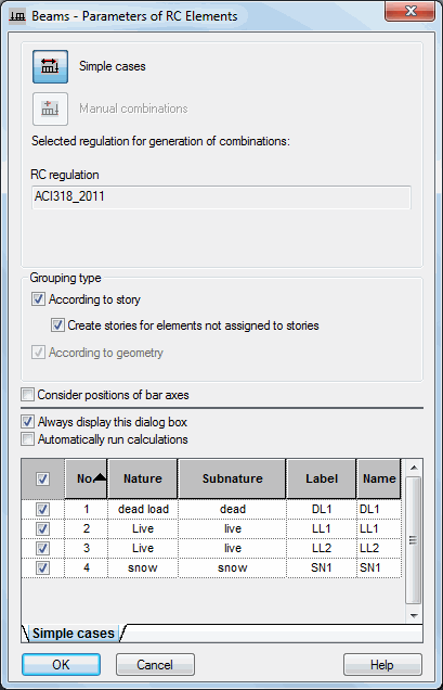

After completing the transfer, Robot displays the Parameters of RC Elements dialog (as in the image below), where you can select combinations, grouping type and so on.
The above dialog displays for RC beams. Other RC element types have their specific dialogs. After you specify and accept the settings in this dialog, the transferred elements are removed from the selection of elements for transfer to RC modules.

In this dialog you can determine the type of loads to be transferred. These are either Simple cases or Manual combinations.
The Grouping type field contains options that allow you to automatically group elements according to certain criteria (this does not work for continuous footings).
According to story. Based on structure geometry , the structure is divided into stories. On their basis levels are created in the calculation tree of the beam and column modules which ascribes elements to the relevant level.
According to geometry. Currently only available to columns. Elements of the same geometry are treated as one calculation element. It is designed for many combination groups resulting from loads acting on individual elements. All elements are designed for the most unfavorable arrangement of loads.
