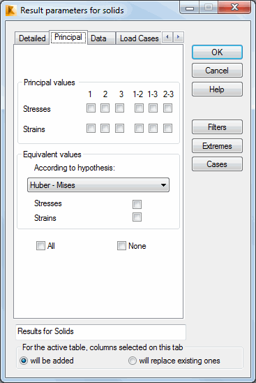

Select the Principal (solids) tab in the Columns dialog to select stresses or strains for presentation.
Reduced values are presented according to a selected hypothesis. They are available on the list located in the lower part of the dialog. Currently, the following hypotheses are available.
