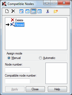

Open the Compatible Nodes dialog using one of the following methods:
This dialog is used to define compatible nodes in a structure. It means that one defines shared nodes with respect to displacement or rotation for the selected degrees of freedom in the points where structure bars are connected (compatibility). Selected nodes are copied. Each node belongs to a different set of bars. All the degrees of freedom in a node, except those indicated by the user, are mutually independent.
For bar structures with intersecting bars, you can get the same values of displacement for bars at their intersection point. To achieve this, use the Compatible Nodes option. The number of nodes with identical coordinates must be the same as the number of bars. Each node belongs to a different bar.
The dialog has the following:
The dialog has the following icons:
Similar to defining other structure attributes, the process of defining compatibility in a structure is divided into 2 steps:
If the active list of compatibility types is empty or a new compatibility type is to be added to the active list, click new compatibility type:
You can also open the dialog for a new compatibility type by double-clicking on the element from the active compatibility types list. The Compatibility Definition dialog opens with all fields filled according to the compatibility type selected. After changing the required parameters, the compatbility type is added (updated) to the active list by clicking ADD or pressing <ENTER>. If you do not change the label, an appropriate warning displays (as in the case of a new compatibility definition.) This option lets you change compatibility types.
