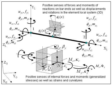

Geometry, sign convention for forces, displacements, stresses and strains
Basic kinematic relationships
In the element local system and in the geometrically linear range, the generalized strains E on the cross section level are as follows (symbol (
indicates calculation of the differential along the direction of the bar axis):
where:
Axial strain in the bar axis: |
e0x = u ,x |
Curvatures: |
K y = fy'x K z = - f z'x |
Average angles (strain): |
b y = n 'x - f z' b y = w 'x - f y |
Unit torsion angle: |
j = f x'x |

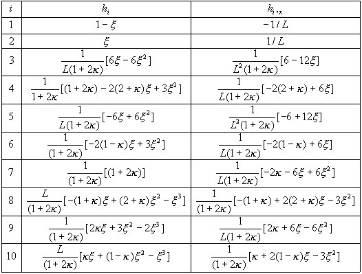

Displacement approximation
When there is a possibility to consider shear influence and consistence of results obtained for the linear element, physical shape functions considering shear influence have been implemented.
2D bars:
Shape functions and their derivatives are expressed by the formulas:
where:
x = x / L
for planes XY and XZ, respectively.
