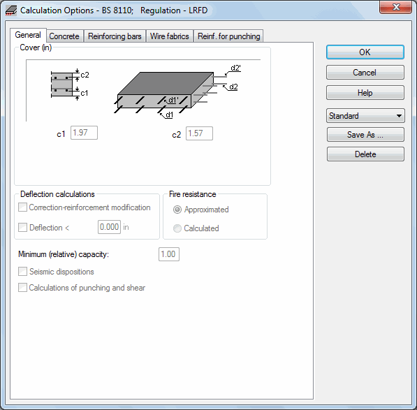

After opening the Calculation options dialog box for RC slabs and selecting the General tab, the dialog box shown below appears on screen.
The options available in the dialog box presented above just show the values of parameters set in the Plate and shell reinforcement type dialog box, which is why they are not editable.
