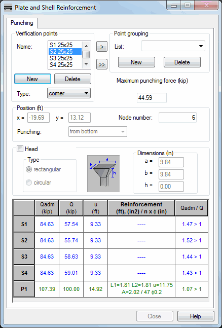

This option analyzes punching in slabs resulting from loads from concentrated forces and reaction forces of slab supports.
This dialog allows the following.
Viewing and Adding the User Defined Verification Point
If point supports are defined in a structure, they are automatically entered on the point list and denoted by the letter S with consecutive ordinal numbers. For each support type the following values display.
To display data of a selected verification point, select its name from the point list.
Independent from supports, verification points can be user defined.
To define a new verification point, click New in the Verification points field. Each time New is clicked, a verification point denoted by letter P and a consecutive ordinal number is added to the point list. Once a verification point is chosen, the definition fields of the point position, load geometry and values of punching force are active. These values are saved (no additional operation to confirm them is needed). To delete the added verification point, select it and click Delete. Points, which are the supports defined in structure geometry (denoted by the letter S) cannot be deleted.

Point Grouping
Both the additional verification points and supports can be grouped to easily modify the geometry. Manually group points by selecting names and clicking >. Group all supports by clicking >>.
Additional verification points can be grouped if they have the same geometry type. In the case of supports, a compatibility of the support dimensions is necessary. If the compatibility conditions of the support dimensions are not satisfied, the verification points or supports (not compatible with the first listed) are deleted at group confirmation.
When points with different dimensions are grouped, dimension values are accepted based on the first defined point in the group. When a new point is added to the group, its dimensions are automatically changed to the be compatible with the group dimensions. Grouping the supports with different head dimensions is done by analogy.
When the group is defined, any change for the arbitrary group component relates to the entire group and is modified.
Presentation of Calculation Results
In the punching analysis for each verification point table, the following values are presented.
Punching analysis results for individual points display in corresponding colors to the calculation result.
The critical circumference is presented graphically on the Slabs - punching layout as a green line around columns. The range of punching reinforcement is shown graphically in a final drawing of a slab (formwork).
