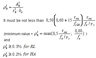

Ahi - Cross-section of horizontal reinforcement within the layer.
shi - Reinforcement spacing.
Percent of horizontal reinforcement equals
Additionally, the following condition should be verified.

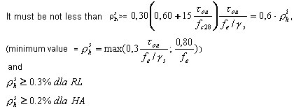

This reinforcement is distributed along the entire span length according to the following.
Symbols:
Ahs - Cross-section of the horizontal reinforcement within the layers.
shs - Reinforcement span.
The percent of horizontal reinforcement equals
In the case when h > l, apply the reinforcement evenly distributed in the zone between l and 1.5*l. The percent of this reinforcement should be smaller than max(0.5*rhs; rhs(min)).
