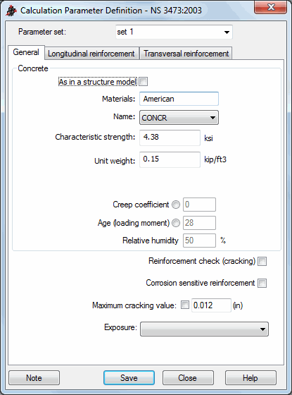

The General tab of the Calculation Parameter Definition dialog box for the Norwegian code NS 3473:
Concrete parameters are defined 3 ways.
The following parameters can be defined.
It should be decided if a beam is to be designed for the perpendicular or oblique cracking width. If selected, cracking width after calculations is not greater than the user defined value of admissible cracking width. If deselected, then the cracking width will be calculated for beams and provided in the table.
Below the exposure determined in the code, LA, NA, MA or SA may be chosen.
