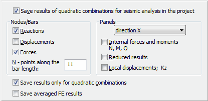

There are two options for saving the results of quadratic combinations.
Select the type of structure dynamic analysis results to be saved once structure calculations are completed. Only the mode combinations of seismic/spectral analysis cases are considered. Robot sets the selected combination type as default. The default combination type can be changed on the Combination Sign tab in the Analysis > Analysis Types dialog. The values are calculated directly after solving the project and are saved with it. This enables faster access to the results for seismic/spectral analysis, though it increases the duration of calculations.
Save results of quadratic combinations for seismic analysis in the project is turned off by default. When off, the remaining parameters of the Seismic Analysis dialog cannot be set (except the Save averaged FE results option).
Adjust the following parameters:
Tables containing the results for bars are opened displaying the number of division points defined in the Job Preferences dialog when the option for saving the dynamic analysis results is on.These may be used in the generation of code combinations.
Select the Save results only for quadratic combinations option to save only quadratic combinations results (single vibration modes results are not saved). The condition for the saving of only these results is to calculate and save the results of quadratic combinations instantly after calculations. Otherwise, there would be no results for a given dynamic case. This will speed up calculations. Note that results other than the selected types are not available. There are no single modes or values of quadratic combinations for them. If the Save results only for quadratic combinations option is turned off, dynamic analysis results are saved for vibration modes. This will result in larger .RTD files and slower calculation times.
Opening a force table for all cases while the option for dynamic result saves is turned on, leads to results not being calculated. They are read from the buffer. In addition, selecting the Save results only for quadratic combinations option and selecting all cases in the force table will lead to the values of quadratic combinations being shown for seismic cases. However, if only one seismic case is selected, then values are displayed by vibration modes and the table will not show results.
Seismic calculations for a large number of eigenmodes require saving a large number of results. Reduction of result size consists of saving only a single, constant result value for planar finite elements. By default, results for FEs are saved at three or four corner nodes of a finite element. Select Save averaged FE results to reduce the number of saved results and decrease the results file size. This should only be used when a degree of lost calculation accuracy is acceptable.
