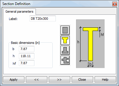

(Section type) or select RC element > Section type in the Deep beam - definition module, to decide which cross-section should be applied to the designed deep beam.
From this dialog you can do the following.
You can select the following cross-sections of a deep-beam: rectangular, T-section, reversed T-section and rectangular with slabs. Depending on the selection of section type, the dialog presents appropriate parameters. The dialog shown above defines the parameters for a rectangular section. Similar options appear when a T-section is selected. When a rectangular section with slabs is selected, a Slabs tab is available.
The << and >> buttons step to the previous and next span of the designed deep beam.
