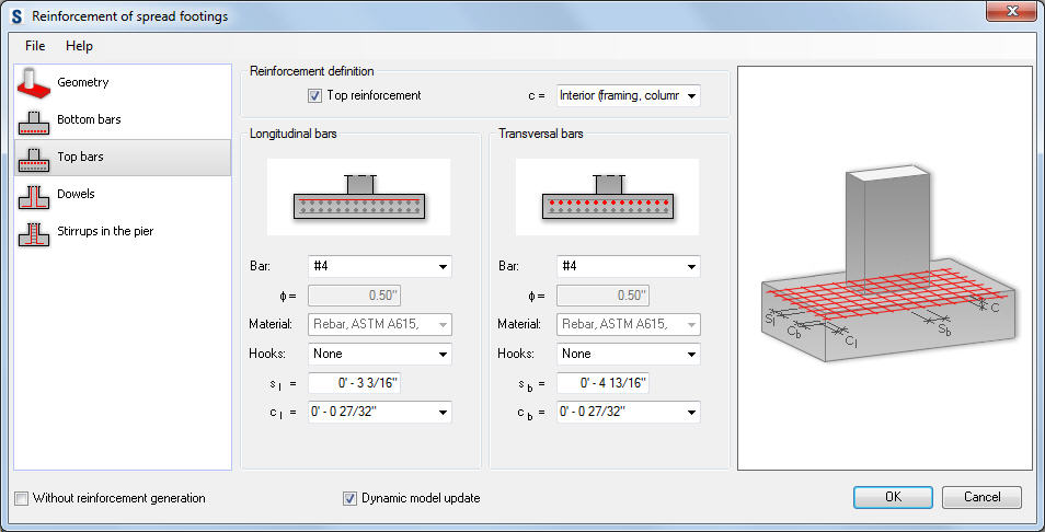

To generate top reinforcement in a spread footing, under Reinforcement definition, select Top reinforcement. You can then define parameters of top reinforcement:
Top reinforcement
Longitudinal bars
Transversal bars
Parameters of hooks and bars are loaded from families defined in Revit. A bar diameter and material are associated with a selected steel grade (family).
