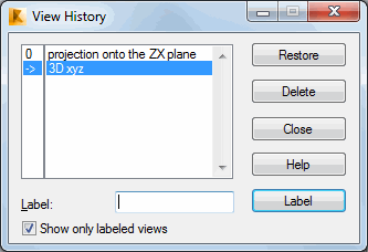

Open the View History dialog, which lets you restore structure views that can be used further during structure creation, using either method:
Views that result from zooming, translation, rotation, projection onto different planes, and the visualization of such structure attributes as: supports, sections, loads, and so on, are added consecutively to the list in the dialog and assigned successive numbers. To name a view, enter a label and click Label. The new name is added to the list of views. To return to the previous structure view, double click the view or select the view from the list and click Restore.
To delete a view from the active list, click Delete.
When the Show only labeled views at the bottom of the dialog is selected, only those views that have a label (name) are displayed.
