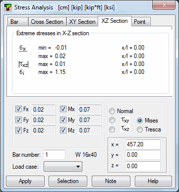

After you select the Section XZ tab in the Stress Analysis dialog, the extreme stresses obtained in the selected XZ bar section are presented.
In the Stress Analysis dialog, the following extreme stresses calculated in the selected longitudinal bar section display:
The coordinate value for which the extreme stress value was obtained is given for each of the listed stress values.
