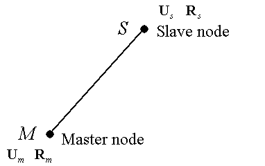

The Rlink element, which is automatically inserted into the place of a defined rigid link during calculations, provides the ability to use a concentrated mass matrix for dynamic problems.
The stiffness matrix for the element presented in the drawing above is as follows:
Cms= matrix of transformation of displacements from the master node to the slave node
Cms trans= matrix of transformation of reactions from the slave node to the master node
Us= displacement vector for the slave node
Um= displacement vector for the master node
Rs= reaction vector for the slave node
Rm= reaction vector for the master node
diag(k)= diagonal matrix created from vector k, which is a vector of stiffnesses ascribed to individual degrees of freedom.
