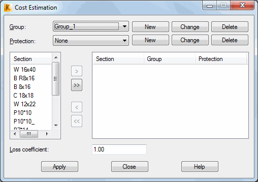

Select Tools > Cost estimate to estimate costs of the designed structure.
To obtain a detailed cost estimate define certain groups of sections. In general, steel sections have different prices, depending on the section type.
To the right of the dialog are sets of buttons for Group parameters and Protection parameters. Each set consists of the following:
When defined, ascribe sections to appropriate groups.
Adds the section selected in the left-hand panel to the right-hand panel. |
Adds all the sections from the left-hand panel to the list of sections in the right-hand panel containing all the element that will be covered by the cost estimate. |
Adds the section selected in the right-hand panel to the left-hand panel. |
Moves all the sections from the right-hand panel to the left-hand panel. |
Ascribing sections to appropriate groups and protection layers ends the process of estimating costs. The cost estimate is available by selecting the View > Tables command from the menu and selecting the Cost estimate option in the Tables - data and results dialog.
