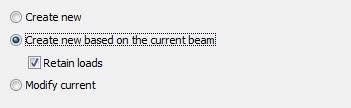

To start the interactive mode of RC beam definition, the user should choose the commandFile / Beam Wizard from the menu in the RC Beam Design module or press the
iconin the RC Beam Design module. The dialog box shown in the picture below appears on the screen then.
In the above dialog box one of the following options may be chosen:
