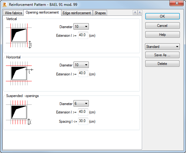

The Opening reinforcement tab allows you to define parameters of opening reinforcement for the BAEL code.
Select RC Design
Provided reinforcement layout, and then create a new RC element or open an existing one.
Reinforcement Pattern.
(Reinforcement Pattern).
Opening reinforcement in RC walls is composed of:
RV = 0,85 * 400 / fe (cm^2)
RH = 2,35 * 400 / fe (cm^2)
The Save As option allows you to reuse a set of reinforcement pattern parameters. This set is saved to your current user directory. You can reuse this set for the other element in the Reinforcement Pattern dialog or assign it to the selected element (or selected elements of the same type) in the RC Component Inspector.
The Delete option allows you to remove the selected set of reinforcement pattern parameters.
