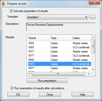

In either plates/shells or volumetric structure types, select Analysis > Prepare Results for defining result preparation for map display.
The dialog includes the following information:
There are four standard templates with basic result sets available.
To calculate results, click Run preparation or activate the Run preparation of results after calculations option. When calculations of a structure model complete, result preparations will start automatically.
You can create user defined templates for preparing results. To start defining a new template, click (...). The Composition of Template for Result Preparation dialog opens.
