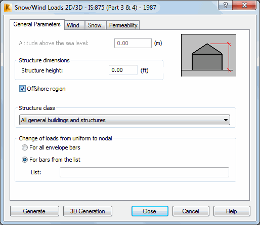

Opening the Snow/Wind Load dialog and clicking the General Parameters tab displays the following dialog.
The dialog has basic options required in the structure design by the national snow/wind code selected in Job Preferences.
In the upper part is the Altitude above the sea level option to specify the altitude above the sea level at which a structure is situated.
The above dialog box is divided into several fields with groups of specific options. The Structure dimensions field has the following options:
A value of the k1 coefficient is calculated based on structure classes on the selection list and the value of the basic wind pressure Vb.
The Change of loads from uniform to nodal field:
