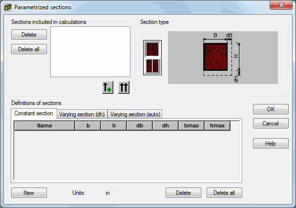

Click the Par. sections button in the Definitions dialog (Groups tab for timber sections), the following dialog displays:
The following section types are available in the Section type field, in the upper right-hand part of the dialog:
When selected, a schematic drawing of the selected section type and the symbol convention for dimensions is displayed. The Definition of sections field allows one to define steel section dimensions.
To define a new section:
To delete sections from the list:
There are three types of sections:
If the defined sections are to be included in calculations, "move" them to the Sections included in calculations field. There are two ways to include defined sections:
Recognizing sections in calculations:
