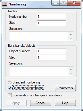

Open the Numbering dialog, which lets you define numbers for nodes, bars, panels, and object, using either method:
The dialog box is divided into 2 parts: Nodes and Bars/Panels/Objects:
Nodes field |
Bars/Panels/Objects field |
Node number - Specifies the new number of the first node. |
Object number - Specifies the new number for the first bar, panel, or object. |
Step - Specifies the value used for the step when numbering nodes. |
Step - Specifies the step value for numbering bars, panels, or objects (such as, arcs, circles, etc.). |
Selection - List of nodes whose numbers will be changed. New node numbering is defined by two parameters: the number of the first node and the numbering step. |
Selection - List of objects (bars, panels, arcs, and so on) whose numbers will be changed. New object numbering is defined by two parameters: the number of the first object and the numbering step. |
The Bars/Panels/Objects field lets you change the numbering for bars, panels, or objects (arcs, circles, polylines).
There are 2 ways for changing the numbering of a structure elements:
At the bottom of the dialog is the Confirmation of Changes in Numbering option. When selected, a change in the numbering of bars, nodes, panels or objects is signaled by a warning message.
To change the numbering of objects in a structure using standard numbering:
To change the numbering of objects within a structure using geometrical numbering:
If no numbering conflict occurs (that is, the new number is not assigned to another node, bar, panel, or object), the numbers of the selected node, bar, panel, or object change.
