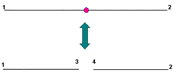

Hinge characteristics are defined independently for each degree of freedom. Defining a hinge for a selected direction divides an element into 2 elements and introduces double nodes to a structure model (see the image below).
After defining a hinge, there are additional, independent degrees of freedom, that is, displacements / rotations in nodes 3 and 4. For directions on which non-linear constraints have been defined, the relationship between the forces and a mutual displacement requires using the DSC (Discontinuity) element, that is a 2-node element where nodal forces are generated according to the formula:
