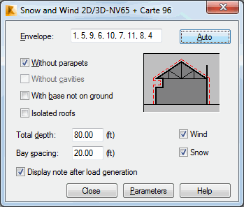

Snow/wind loads can be generated by
The Snow/Wind Load dialog has conditions for which snow/wind loads are generated:
To select an envelope:
To define snow/wind loads, you must specify basic parameters for the structure:
At the bottom of the dialog, there are the following 2 options:
At the bottom of the dialog is the Display note after load generation option. When selected, Robot runs the text editor that displays the load values it calculated for individual snow and wind load cases. When cleared, Robot saves the files containing the calculation notes for the snow and wind loads cases to the local user folder \Users\...\Documents\Autodesk\Output.
Clicking Parameters opens the dialog for setting detailed parameters for snow and wind loads.
