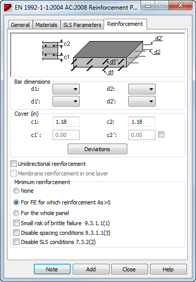

The Reinforcement tab allows you to define reinforcement parameters.
Required Reinforcement of Slab/Walls - Options
Code parameters to open the Plate and Shell Reinforcement Type dialog, and then click
Define the following reinforcing bar diameters:
Define the following reinforcing covers:
Define the following additional parameters:

Specify the following criteria of generating the minimum reinforcement in RC panels:
You can also define additional parameters for the control of minimum reinforcement which may be available for ACI 318 and EN 1992-1-1:2004 AC:2008 with all National Annexes codes.
Minimum reinforcement considers all code combinations and all load cases. Reinforcement may be calculated for one side of a section, both sides, and for a whole section (separately for each instance) depending on code requirements.
