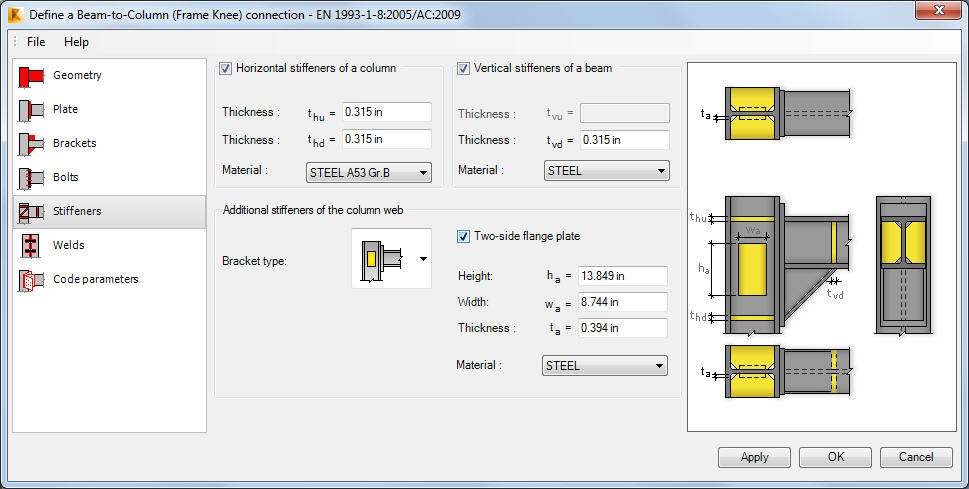

Use the Stiffeners tab to define vertical stiffeners for the beam and horizontal stiffeners for the column.
Parameters for stiffeners of the column web include:
Select Horizontal stiffeners of a column or Vertical stiffeners of a beam to define horizontal stiffeners of the column or vertical of the beam. Specify the following parameters for these stiffeners:
