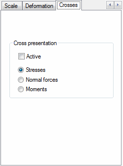

Select the Crosses tab the Maps dialog to modify planar finite element crosses.
Results for planar finite elements can be presented as isolines (maps) or crosses. Click Active to present crosses of a selected quantity. Results may be presented in the form of crosses for stresses, forces and moments.
