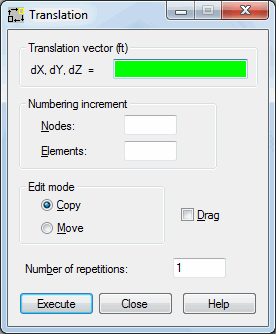

To define a translation, set the main parameters in the following fields of the Translation dialog:
Also, define the translation vector in the (dX, dY, dZ) field for the 3D view or in the (dX, dY) field for the 2D view.
After you defined the translation vector graphically, Robot translates selected elements or nodes, or if no objects have been selected, click Select in the context menu to select them. Robot remains in translation mode until the next command is selected or the <Esc> key is pressed.
If you manually defined the translation vector in the dialog, clicking Execute completes the action.
If you have selected only bars (without nodes), Robot translates these bars by a translation vector without changing the position of adjoining bars. If you have selected nodes of a bar, Robot snaps the adjoining bars to a new position of the translated node.
After selecting the Grid or Auto cursor mode, the coordinates for the translation vectors are displayed in the (dX, dY, dZ) field. For the Node mode, the number of nodes defining the translation vector is displayed in the (dX, dY, dZ) field. The Translation vector field depends on the cursor mode:
Depending on the view selected (2D or 3D) in Robot, the field for defining the translation vector varies:
