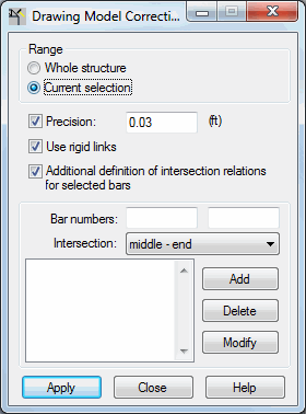

This option improves the geometry of a structure model that was imported from a drawing program so that a correct calculation model of the structure is generated. The correction consists of extending or reducing the length of the bars so that the structure bars intersect. Open the Drawing Model Correction dialog by clicking Edit menu > Correct Drawing Model.
At the top part of the dialog, the Range field has the following options:
When Precision is selected; you can enter a distance value (value of the precision parameter) that defines the range in which corrections for a structure drawing model will be made. They corrections are made only when the distance is smaller than precision. When Precision is cleared, the drawing model is automatically corrected by the precision value used by Robot.
When you correct an imported structure model, the original bar directions are retained. In most cases, the correction involves extending or reducing the length of a bar. However, if there are bars which do not lie in one plane, but extend close to each other on 2 different levels, using the Use rigid links option generates rigid links between these bars.
When Additional definition of intersection relations for selected bars is selected, the options at the bottom of the dialog become available. This option lets you determine whether the selected bars should intersect (if yes, then in what way) or not.
To define additional intersection relations of two bars:
The intersection relation between the indicated bars is added to the list of defined relations in the bottom left of the dialog.
Clicking Delete, deletes the bar intersection relation from the list; whereas, clicking Modify lets you change the parameters of an intersection relation on the list.
When Apply is clicked, the structure drawing model is corrected.
