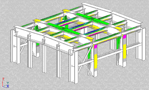

Stress Maps - click Results menu > Stress Analysis > Stress Maps to display a structure with section shapes and accurate detailed stress maps on these sections as shown.
