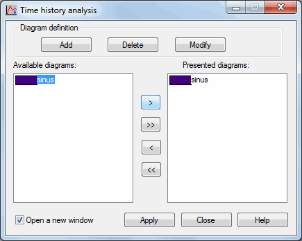

You can display results of time history analysis as diagrams, maps or structure deformations. You can draw diagrams for the envelope or for each of the time components. After selecting the additional load case (+/-) generated for envelopes, Robot displays envelopes.After selecting the main case, the results of a single component with particular time steps become available. Select Results menu > Advanced > Time History Analysis - Diagrams to display the following dialog.
Graphical results of time history analysis are presented as time-dependent diagrams of a selected quantity in a selected time history analysis case.Diagrams and tables with their descriptions display in the Time History Diagrams window.
Time history analysis dialog
Add - Opens a dialog for defining a new function
Modify - Opens a dialog box for defining a function (you can change the function name or value that is currently selected on the selection list)
Delete - Deletes a definition of the function that you selected on the list
> - transfers a selected diagram to the right panel
>> - transfers all diagrams to the right panel< - deletes a selected diagram from the right panel
<< - deletes all diagrams from the right panel.

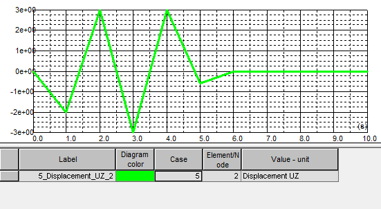

The panel with defined diagrams has 2 types of functions:
After defining diagrams and transferring them to the Presented diagramspanel, click Apply to display selected diagrams in a window. An example of a diagram for a time history analysis case is in the following image.
In the upper part of the image are diagrams of selected quantities, superimposed in one image. The values of abscissa are the time variable values.Diagram descriptions and values of the extremes for selected quantities are in the table.
Click the table and righ-click the mouse to open the context menu and select Columns. It opens a dialog to select quantities to be included in the table below time history analysis diagrams.
Context menu options (Diagrams - properties menu):
