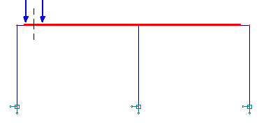

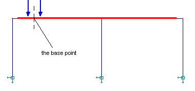

The effect is described in the example in the following image. The route is displayed in red; the vehicle consists of two forces marked in blue, at a certain distance from each other. (The base point - the center of the vehicle is at the middle of the distance between the forces.)
If the Vehicle position limit - route beginning/end option is selected, the vehicle cannot be located beyond the position shown below.

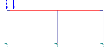

If the Vehicle position limit - route beginning/end option is cleared, the vehicle cannot be located beyond the position shown below.
