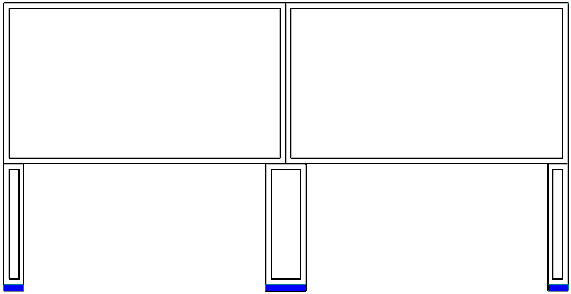

A model of a two-span deep-beam that is supported on columns is shown below. For the pinned support on columns, the thickness of columns is adopted as equal to the thickness of the deep-beam panel.

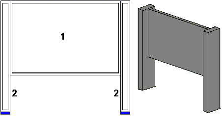

Pilasters are columns of a thickness greater than that of the membrane which is fixed to them. It is assumed that these supports extend over the entire height of a deep-beam. When a pilaster is modeled, its thickness perpendicular to the membrane plane is additionally defined. The following designations are adopted in the drawing below.
1 - Panel of the thickness defined as the deep-beam thickness.
2 - Panels of the thickness defined as the pilaster thickness.
