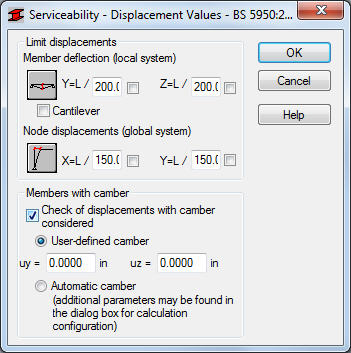

The option is used to define additional code parameters determining displacement values (limit displacements). It is available after pressing the Service button in the Member Definition - Parameters dialog box.
The user may define limit displacements (member deflections in directions X and Y, node displacements in directions X and Y) and additionally, when defining member limit deflections, the user may determine, if the member is a cantilever. In the bottom part of the dialog box parameters of members with camber may be defined:
