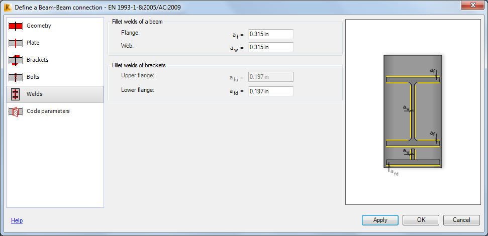

Use the Welds tab to define the thickness of welds connecting beams with the front plate and the thickness of welds connecting brackets.
This tab is available only if Welded connection is selected on the Geometry tab.
You can define the following thicknesses of welds:
