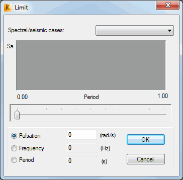

Click Limit Definition in the Modal Analysis Parameters dialog to define the limit value of frequency, period and pulsation for the structure modal analysis. When the appropriate limit value is achieved, the calculations are completed.
The limit range may be defined graphically or by assigning the appropriate value.
To define the limit state, do the following:
All seismic and spectral structural analysis cases defined for the selected modal analysis appear in the Spectral/Seismic Cases field. Once one of the spectral or seismic analyses is selected, its spectrum appears in the appropriate field.
