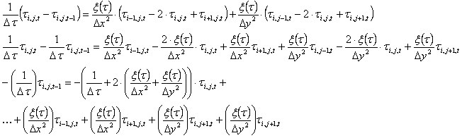

The equation of the heat flow inside the contour shown below may be presented as follows.
where:
C p - Specific heat (J/kg*K)
λ - Thermal conductivity (W/m*K)
ρ - Unit weight (kg/m 3).

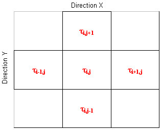

In the differential notation the heat flow equations can be written as:
These equations yield:
Thus, for K nodes, the system of equations M[KxK] x τ[K] = B[K] will be solved.
