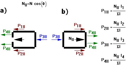

Distribution of forces in welds due to a load parallel to the chord

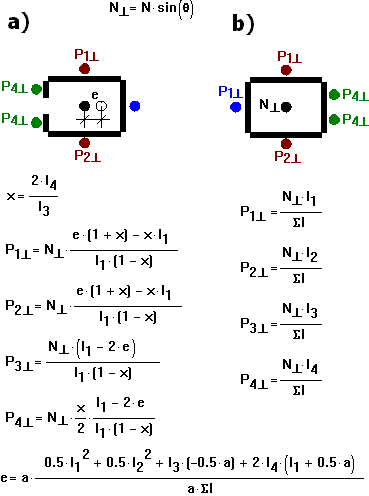

Distribution of forces in welds due to a load perpendicular to the chord

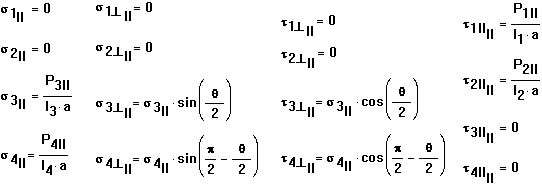

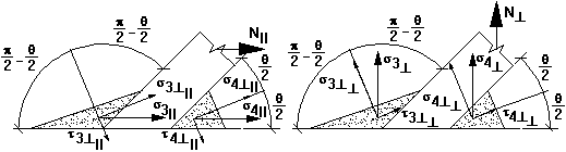

Distribution of stresses in longitudinal welds

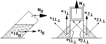

Distribution of stresses in transversal welds

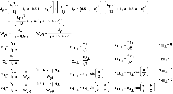

Formulas for resultant stresses in welds (longitudinal 1, longitudinal 2, transversal internal 3, transversal external 4)
