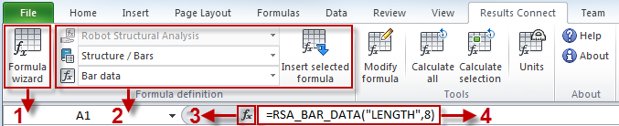

Use Project Octopus to insert, modify or calculate formulas in Microsoft Excel.
You can define formulas, that allow acquiring information from Autodesk Robot Structural Analysis Professional project, using either of the following ways.
You can access it from the Ribbon by clicking Results Connect tab
Formula definition panel
Formula wizard.
You can specify the following settings by using selection drop-down list available on the Ribbon:
Insert selected formula.
You can access it from:
Function library panel
Insert Function
Insert Function icon.
