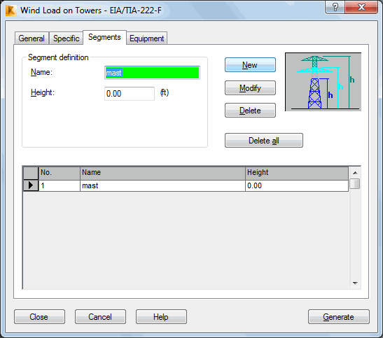

Opening the Wind Load on Towers dialog and clicking the Segments tab displays the following dialog.
For mast structures (such as, high-tension pylons, broadcasting masts, and so on.), the entire structure is divided into segments defined by specifying several parameters. Dividing a structure into segments requires information concerning total load values for the entire segment in a calculation note.
To define a structure segment:
