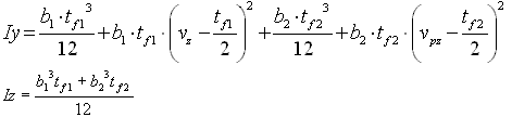

Position of the section centroid
Moments of inertia about Y and Z axes, respectively, of a section made only of flanges
