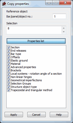

Open the Copy properties dialog using any of the following methods:
Use this option to quickly assign attributes based on parameters copied from objects created earlier. You can use this option to copy all attributes of an object (such as, for a bar: sections, releases, hinges, and so on) to other objects.
The option works as follows:
If you select Copy Properties from the shortcut menu, then indicating successive objects copies properties from a highlighted object (reference object).
When you select Copy Properties from the menu, a dialog displays:
Clicking Apply button copies the selected parameters of the reference object to the selected objects.
