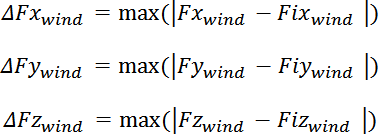

To measure the total forces convergence over a specific time period, the resultant forces
, and
are calculated and stored for a number of steps n, and then the maximum change for a given moment is calculated as follows:
Where
, and
represent the stored values of
, and
for a given step, and for i=1 to n.
