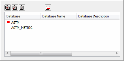

Select either Databases > Reinforcing bars or Databases > Wire fabrics database in the Job preferences dialog tree to access the following database listing.
Currently active databases are listed in this dialog. Organize the list with the following tools:
- Click this button to add a new reinforcing bars / wire fabrics database.
- Click this button to delete the selected reinforcing bars / wire fabrics database.
- Click this button to set the currently selected database as the default.
