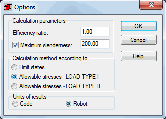

Use this dialog to define parameters for steel member verification. Access the options by clicking the Options button in the Manual Verification dialog. The following dialog displays:
Three calculation parameters are defined:
Moreover, you can select the units to be applied during the presentation of member design results. The results may be presented in the units used in the selected steel code, or in the units used in Robot.
