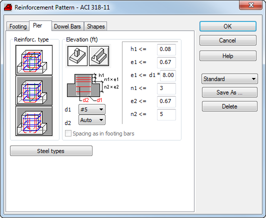

The Footing tab allows you to define the reinforcement parameters of the pier.
Select RC Design
Provided reinforcement layout, and then create a new RC element or open an existing one.
Reinforcement Pattern.
(Reinforcement Pattern).
h1 - Distance of the first stirrup from the top of the pier
e1 - Stirrup spacing (in the first layer from the top). An absolute or a relative value to the bar diameter may be entered.
n1 - Stirrup number (first layer)
e2 - Stirrup spacing (second layer from the top)
n2 - Stirrup number (second layer from the top)
Diameter option (d1, d2)
Defines the horizontal reinforcement diameter (for footing) and vertical (for footing and continuous foundation) for piers.
Spacing as in footing bars
This option is available for continuous footing. Imposes vertical stirrup spacing identical to the longitudinal bar spacing in the footing.
