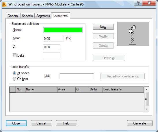

Opening the Wind loads on towers dialog and clicking the Equipment tab selected, displays the following dialog.
The options on this tab define additional surfaces that have significant influence on structure loading with wind, such as antennas, tables, structure fillings, and so on.
To define additional surfaces for a structure:
