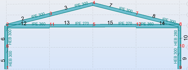

In a structure such as the one above, the following connections can be found.
| Node | Bars | Type | Compatible Connections |
| 3 | 2, 3 |
Beam Splice
All types of plates |
| 7 | 7, 8 |
Beam Splice
| 5 | 13, 15 |
Beam Splice
| 11 | 12, 13 |
Beam Splice
Web plates, bars offset |
| 12 | 15, 14 |
Beam Splice
| 6 | 5, 6 |
Column Splice
| 10 | 9, 10 |
Column Splice
