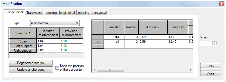

The option allows you to modify reinforcement for RC beams. The option is available from menu after selecting the command: Reinforcement / Modify
After selecting this option the following dialog displays.
The dialog consists of several tabs which allow to modify reinforcement:
In order to start the reinforcement modification, the type of the reinforcement to be changed should be indicated (it may be done in the reinforcement table or in the graphic viewer) and the reinforcement parameters should be modified (e.g. a bar diameter, a hook length and angle etc.).
There are additional options in the Longitudinal tab:
Regenerate stirrups - pressing this button updates stirrups after changes carried out for longitudinal bars (change of longitudinal bars diameter)
Update anchorages - pressing this button changes length of the anchorage of the bars if the diameter of the longitudinal bars was changed.
Keep location of the bar center - if you activate this option, the length of the longitudinal bar during the length duration will be increased symmetrically with respect to the bar center (see drawing below: 1 - the option is off, 2 - the option is on).
