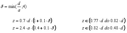

Symbols:
d - Serviceable height of the cantilever cross-section.
a - Distance between the location of the resultant load and the face of the cantilever support.
L - Length of the cantilever measured to the support face.
Verification of stresses in concrete:
Calculation of reinforcement:
