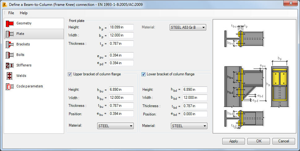

Use the Plate tab to define parameters of the front plate and flange plates.
This tab is available only if Bolted connection is selected on the Geometry tab.
Specify the following parameters of the front plate:
Select Upper bracket of column flange or Lower bracket of column flange to define an additional (upper or lower) bracket of the column flange.
Specify the following parameters for each of these brackets:
